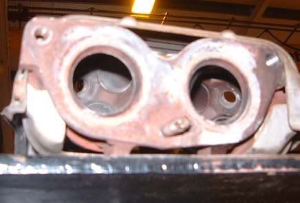

Decatting the precats...
Actually getting the precats out is pretty simple, here's what mine looked like from above and below before I started, you can see some of the degradation thats taken place in the first photo:
And here are the surgeons tools
Removal is simply a case of attacking the precat matrix with hammer and screwdriver until its broken up into lumps small enough to be able to get them out through the lower exhaust port. The ceramic material gives up very easily, it only takes 1 or 2 taps on the screwdriver to do this...
After digging around for a while you will also expose the glass fibre that surrounds and supports the cat matrix, this has to come out too.
Once out you'll have a big pile of very useless, but rather expensive catalytic material left over. I beleive some places do recycle this stuff to reclaim the precious metal content, so if your now feeling guilty about your effect on the environment, this could be a way to ease your concience
Once its all out, you'll be left with an empty manifiold like this;
You now need to clean it, as there is still an awful lot of potentially damaging dust and particles left inside. I would recommend high pressure water like a jet wash or an airline for this, as an chemical residue from solvent cleaners may have a damaging effect on the O2 sensors.
Once clean and dry, re-building is simple the reverse of the process used to take the manifold out in the first place.
Happily, I've not noticed any increase in noise level from removing these. Performance certainly isnt any worse, and in fact the car may have benefitted in the form of slightly increased torque, but I cant say for sure... What is certain though, is that the pre-cats are going to have a hard time damaging my engine from the workshop bin, and I'm a lot happier now that these ticking time bombs are not a problem...MOT tests wont be a problem, as I still have the main cat in place, which is more than capable of doing the work. I dont have a ULEV car anymore, but I do have one that with a bit of luck will last a bit longer.
