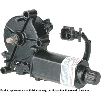

Post by jimi » 12/01/18 0:17
MK2 motor showing the splined shaft
Black is not a colour ! .... Its the absence of colour

yeah, was having a chat with someone else who had suffered the same issue. they did manage to remove the arm (though they said it was on firmly) and move it round on the splines. It is prob only 1 spline out, think 2 would be too far. Will have to address it over the weekend, think that motor is coming out :D

The splines are tapered (like a wiper arm) so you need to release it from the taper, usually levering it from 2 sides similtaneously will get it.

So been messing with this for an hour or 2. Tried to adjust the arm position with the plug off but with power restored it goes back to it's old position.
Tried to reposition the arm on the splines but despite marking the position with tippex, managed to spend quite some time trying to get it anywhere near the correct angle. The end result was about the same as before. The spindle seems to change position slightly each time it's rotated.
For now I've pulled the fuse again and adjusted by hand. Looks like replacement motor time for the right hand light.

From your description it sounds like the limit switch is acting up, I'd say your correct, it's motor replacement time
