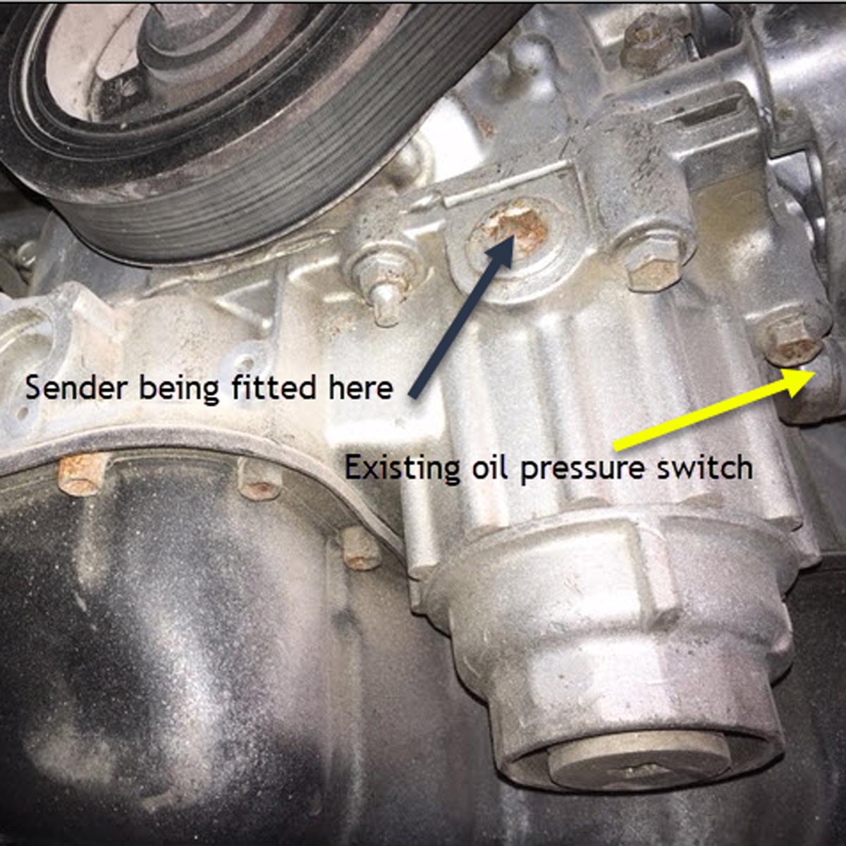

Sorry guys missed the obvious - attached shows the existing oil pressure switch and the plug we used for the pressure sender.

gavsdavs wrote: 19/06/18 9:08
2GRs have a lot of sensors on them - it's a lot more modern than a 3S :)
Still doesn't have an oil pressure sensor, only a pressure switch ;)

Lemuts wrote: 19/06/18 9:39 Sorry guys missed the obvious - attached shows the existing oil pressure switch and the plug we used for the pressure sender.
Looks like a similar location to these available on the gen3 3s engines:
Great way to fit a sensor IMHO.
