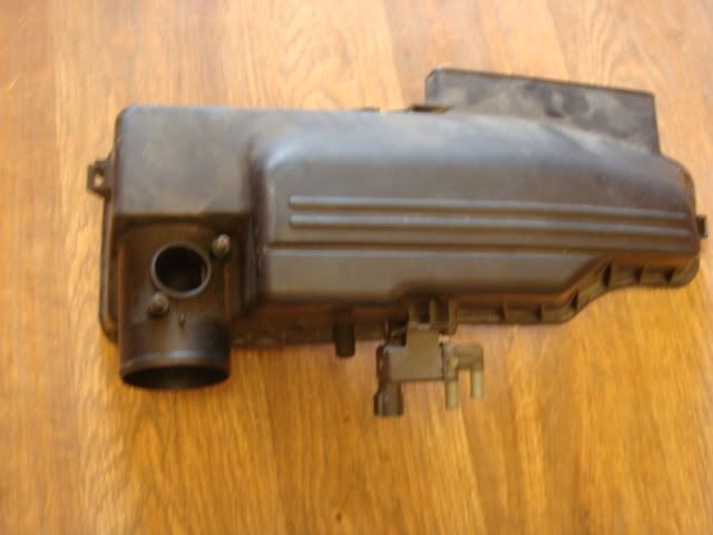

For the air intake I used the 2zz rubber pipe off the throttle body, then my elise parts maf housing with my universal induction kit after that
